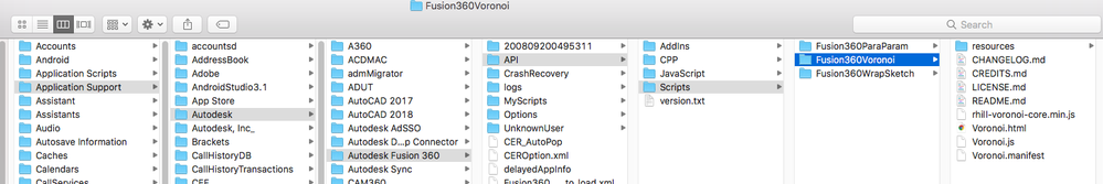

Message 16 of 17
jschmidt1340
I haven't been able to get this script to install. I have followed all available instructions. I have copied the contents of the folder to:
~/Library/Application Support/Autodesk/Autodesk Fusion 360/API/Scripts
I receive the error:
Any assistance is appreciated!
Message 17 of 17
hanskellner
I've verified that I'm able to install and run the Voronoi script on my Mac.
To clarify, did you extract the files into a new folder within the Scripts folder?  For example:
~/Library/Application Support/Autodesk/Autodesk Fusion 360/API/Scripts/Fusion360Voronoi
The error indicates the files might have been copied into the Scripts folder or into another folder that already contained another script.  Please verify that you have extracted the files into a new and empty folder.
