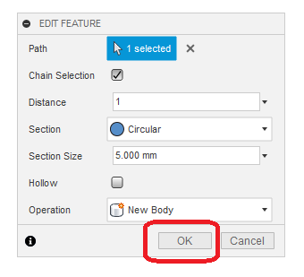

Most are the source code for creating sketches. The part I want to explain is the list "txtCmds" in the initPipe function.
・'Commands.Start PrimitivePipe'
"Commands.Start <commandID>" displays a dialog with the specified command ID.
There is a “CommandDefinition.execute” method that performs similar processing, but the execute method is executed collectively after the script ends, whereas “Commands.Start” is executed immediately.
Therefore, it can be used even in the middle of the script.
(This is a big difference)
"PrimitivePipe" is the command ID of the pipe command.
・'Commands.SetDouble SWEEP_POP_ALONG 1.0'
・'Commands.SetDouble SectionRadius 0.5'
“Commands.SetDouble <commandInputsID> <value>” sets a real number to the Command Inputs of the specified dialog.
The ID of Command Inputs is like this.
Distance → SWEEP_POP_ALONG
Section Size → SectionRadius
・'NuCommands.CommitCmd'
This is the process of pressing the OK button in the dialog and executing the command.

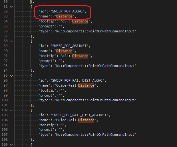

〇Find ID
To do these things, you need to find the <commandID> or <commandInputsID>.
Next, I will explain how to check these IDs.

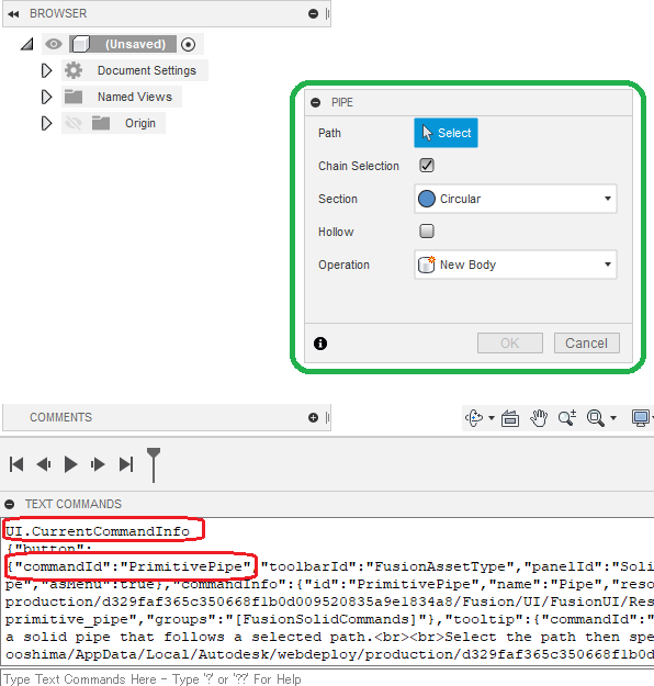

・commandID
I think there are several ways to check the commandID. Since it's a break, let's use a text command.
Display the dialog of the arbitrary command, display the TextCommand(Txt), and execute the following.
"UI.CurrentCommandInfo"
Many characters are output, but you can find "commandID" by checking near the beginning.
・commandInputsID
You can confirm it by executing "UI.CurrentCommandInfo" in the same way.
(Hidden Inputs are also listed)
The output characters are probably in JSON format.
InputsID corresponding to "Distance" displayed in the dialog can be found by searching the output characters.
In the case of "Distance", it was found in multiple places. What is the desired ID?
...There seems to be no way other than actually trying this.
