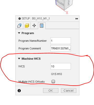

Is it possible to use API to add new fields to the existing setup dialogue on the post process tab?
I'd like to add WCS xyz positions to each setup that I can the call up in the post to add to the work offset macro.

I'm not sure if I have correctly relayed what I'm trying to do. Here is a
quick sketch to show what I'm wanting to achieve.
This is for the Okuma HB 5000 machine definition using the current post
definition.
[image: Setup WCS Example.PNG]

@Shannon_IMD -San.
My apologies, I misunderstood your question.
You cannot change the standard command dialog.
Shannon_IMD
Thank you for the reply. I guess that idea is done then so i can stop wasting time on it. I'll have to find another solution.
