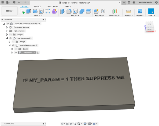

martin.devarda
I need to conditionally suppress a feature using a script.
I've found some threads about this issue, but no trial code nor working examples. I tried to do it by myself but unsuccessfully. I'm not a developer (just some Javascript for web pages) and I the learning curve of the scripting environment is too steep for me.
I share a basic design to play with. If anybody could drop some lines of code to conditionally suppress the last feature, it'd be very helpful.

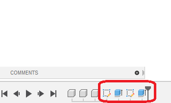

Hi @martin.devarda .
I created a script for trial.
After running the script, select a timeline.
Toggles Suppress <-> Unsuppress.
