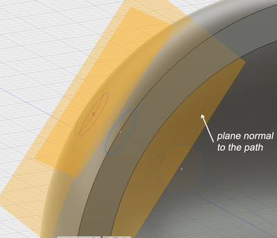

Hi sgraves, sorry for the delay. I have read your replay and I have done some attempts to try to understand your advices.
This picture sums up my issue:
I have a sketch in which there is a close curve (in this case for simplicity a circle), and I want  to project it to the cap along the line  that connect the external point on the z axis with the center of the circle.
Your advice to project it to a plane that is normal to the direction of the line means that I have to project the curve on a ‘plane along the path’ of the line.
The projection of this resultant curve on the plane tangent to the face of the body has this result:
While the projection ‘along a vector’ in the direction of the line has a different result:
As you can see the projection are different.
I thank you for your reply and for your answer
Dino

Hi ekinsb, thanks  for your reply and sorry for my delay. I’ve tried your advice and it is ok. I used the sweep operation instead of the loft and I found the right intersection.

sgraves
@dinocoglitore  Now if you extrude the projection on the normal plane to the vector, I believe the intersection of that extrusion with the surface is the shape you are looking for.  Sketches have an intersect method, but for a more general surface I don't know.  Perhaps something can be done with the Interference tools.
Message 11 of 11
sgraves
@dinocoglitoreand @ekinsb,
I see the sweep is a beautiful solution.  With the sweep along the vector you get the desired shape without creating the normal plane.  In fact the intersection of the sweep with the normal plane is basically how the projection on the normal plane is made.  And in fact as @dinocoglitore has discovered the projection on any surface can be done with the intersection of the sweep.
