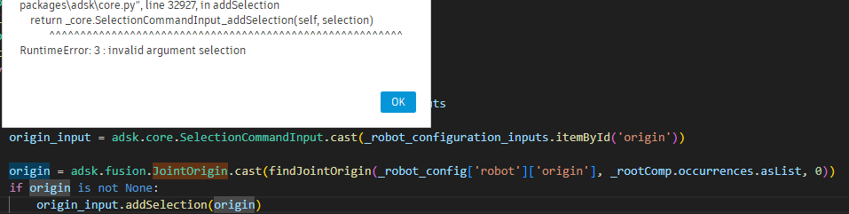

I have a script that needs to load selections saved in a yaml file. The selectionCommandInputs are created in the CommandCreateHandler. After the commands are created a custom event is fired that selects the saved selections.
It works fine for Occurences and Joints, but fails with runtime error 3 when trying to add a JointOrigin.
The origin_input has a selectionFilter for 'JointOrigins' and number of selections is limited to 1.
Am I doing something wrong here?

One thing I would try out is to get the JointOrigin with assembly context and return it from your findJointOrigin function. That way the selection has the information for which exact JointOrigin you are specifying.
Not entirely sure what your findJointOrigin function looks like but it seems you are iterating through Occurrences, so when you find the JointOrigin
return foundJointOrigin.createForAssmeblyContext(occurrenceInList)
Here's some more info with regards to this at the bottom in the "Proxies" section https://help.autodesk.com/view/fusion360/ENU/?guid=GUID-88A4DB43-CFDD-4CFF-B124-7EE67915A07A

awesome, many thanks. I'm starting to wrap my head around these proxies...
like you suggested I modified the findJointOrigin recursive function to also return the occurrence the found joint origin lives in, that way I can create the proxy and successfully add it to the selection. Here are the respective code snippets for anybody interested:
