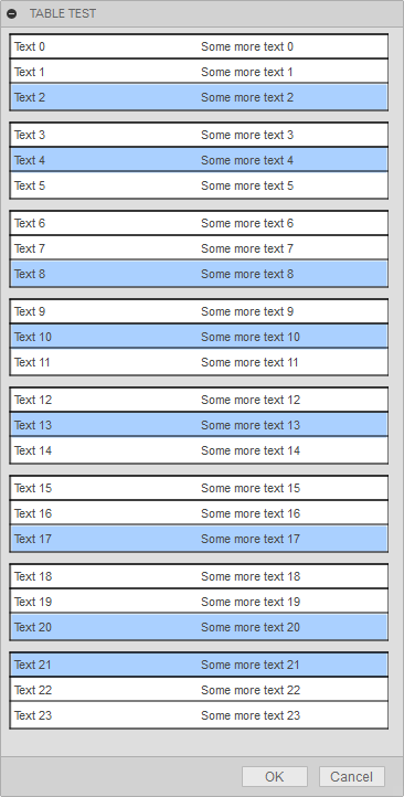

Hello, I have a couple of question about the Table Command Input.
First question, why is it that after creating 4 tables with content, if I create any more tables, the ones after the fourth one are empty. For example, I try to create 7, but the last 3 are empty, like in the picture below.
Also, in order to select a table row, why do I have to click the top right corner of it to select it, versus clicking anywhere in the row/cell. It is hard, as it is a very small area to click.
887 Views
ekinsb
I'm not able to reproduce the problems you described.  Below is my simple command dialog with eight tables.  I'm also able to select a row by selecting anywhere within a cell.
Here's the full code of my test script:

            for i in range(8):
                table = adsk.core.TableCommandInput.cast(inputs.addTableCommandInput('table' + str(tableCount), 'Inputs', 2, '1:1'))
                table.minimumVisibleRows = 3
                table.maximumVisibleRows = 3
                table.columnSpacing = 1
                table.rowSpacing = 1
                table.tablePresentationStyle = adsk.core.TablePresentationStyles.itemBorderTablePresentationStyle
                table.hasGrid = True
                tableCount += 1
                # Create a selection command input and add it to the table.
                for j in range(3):
                    text = inputs.addStringValueInput('texta' + str(textBoxCount), 'Text ' + str(textBoxCount), 'Text ' + str(textBoxCount))
                    text.isReadOnly = True
                    table.addCommandInput(text, j, 0, False, False)
                    text = inputs.addStringValueInput('textb' + str(textBoxCount), 'Text ' + str(textBoxCount), 'Some more text ' + str(textBoxCount))
                    table.addCommandInput(text, j, 1, False, False)
                    textBoxCount += 1

Brian Ekins
Mod the Machine blog
Thank you Brian, through your answer I solved my problem.
So, I was able to solve my problem by changing the
table.minimumVisibleRows to 0
and table.maximumVisibleRows = len(MyList)
Thank you very much.
