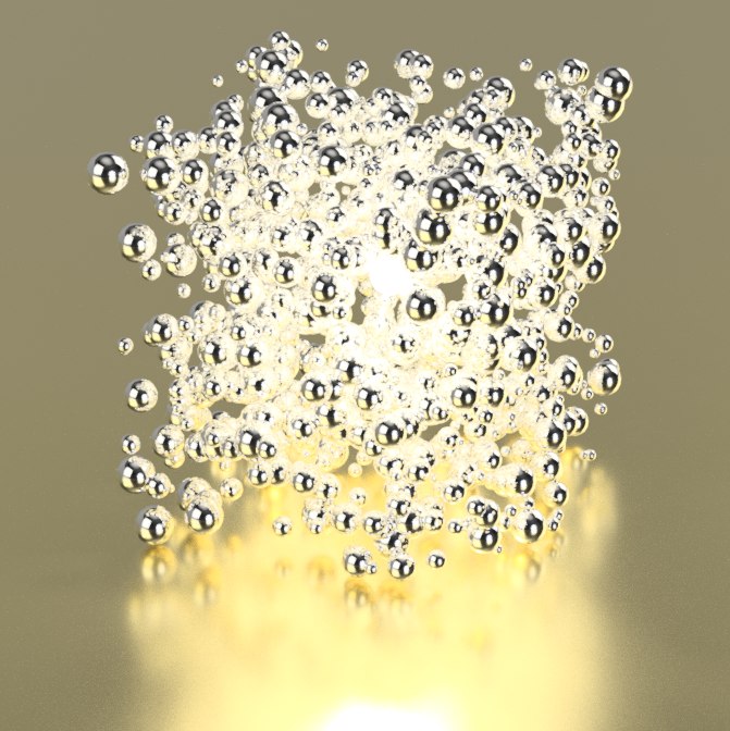

Here's a script that reads a CSV file and creates spheres.  I extended it so that instead of just the center of the sphere it also reads the radius from the CSV.  I use the temporary B-Rep capabilities of Fusion to create the spheres and a direct modeling document to speed up the process.  I was also curious about one other thing and made an option where it will either create one single body for all spheres or a body for each sphere.  For a single body, it takes 1.3 seconds to create 1000 spheres and for individual bodies it takes 5.08 seconds.  Interactively, Fusion wouldn't let you create them as a single body but through the API you can.  I haven't found that it causes any issues but I wouldn't want to do a lot of additional modeling with a model like that.  It's a valid solid model for the modeling kernel but Fusion simplifies it further.
For fun, here's an example of the result where I set one of the center spheres to be a light source.
