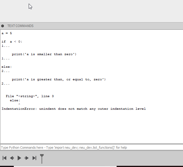

If I type a block of conditions in the the console, like:
if a < 0:
   print('a is smaller than zero')
else:
   print('a is greater than , or equal to zero')
I get
  File "<string>", line 3
    else:
IndentationError: unindent does not match any outer indentation level
Typing the very same thing in a standard console (with Fusion 360 python.exe) give the expected result, without any error.
Not sure if it's true, but this leads me to believe there is some kind of problem with the console integrated into Fusion 360.

Le_Bear
Thank you Jerome. I did not cut and paste, but entered the code, line after line, NOT in Spyder console, but in Fusion 360 "console". As you said, actually it works as expected in Spyder console, or any other console, for that matter. Which is why I suspect a bug in Fusion 360 implementation.

marshaltu
As you may be aware, the functionality in text command window didn't intend to provide a full python console in Fusion 360. If you know more about the history of Fusion/API, we had delivered a set of old APIs (e.g. list in neu_dev module) based text commands. That would be to let users be able to check/try the api quickly. The set of APIs still work today. But we don't recommend clients to use them.
Essentially we use Python to interpret/execute the codes in background. So it also supports to run new APIs. Unfortunately there would be some flaws when we implemented it so that it looks not to be as powerful as a real Python console.
Marshal

Le_Bear
Thanks you Marshal,
No, I did not realize it was not a full implementation. But now I know, thanks to you! 🙂
