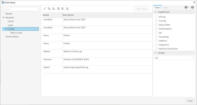

Is there a way to pull a post file from a linked folder using the API?
Thanks.

dames123
Hi @boopathi.sivakumar
Yes. I have a script that currently pulls a post from the Fusion local folder and I would like to change that to a linked folder. Maybe @Jorge_Jaramillo has some insight?

dames123
Hi @Jorge_Jaramillo ,
Yes, you can link a folder on a network share for your team to access. I know I should probably use the cloud but I prefer a hard copy.
