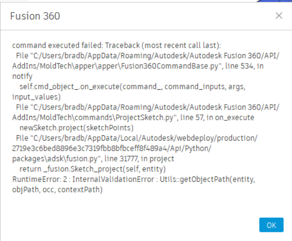

Hello all, I am trying to project points from one sketch into another.
sketches = activeComp.sketches
newSketch = sketches.addWithoutEdges(xyPlane) # User selected surface
newSketch.name = strResult # strResult = 'Selected Sketch Name'
sketchPoints = moldBaseComp.sketches.itemByName(strResult).sketchPoints
newSketch.project(sketchPoints) # Line 57 (error)
Then I get the error message
I've tried several different things from the forum and help but can't figure it out.
Help please.

Hi @brad.bylls .
Probably the proxy is not getting enough.
Here is the result of running the following sample with the attached file.

brad.bylls
I only needed to change the last line to
 [newSketchProxy.project(p) for p in sketchPoints]
