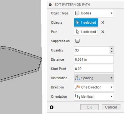

I am working on making my metric thread program P_ThreadTune work with English threads. I got most of the code working, but then ran into an accuracy problem with the English threads using the Path Pattern Feature. I seem to be only able to get 3 decimal place accuracy when using the Path Pattern feature within the API.  I did not see the problem with metric since the pitch never went past 2 decimal places. With English threads designated as Threads Per Inch, I need more accuracy. I am not having an issue with the accuracy with drawing the helix the correct height or extruding the correct height. I can manually go back through the timeline, edit the Pattern on Path with the correct distance & it will work. So, in Fusion it is working for me, but in the API it is not. Am I doing something incorrectly here? I tried using the createByString method & rectangular pattern also, but I seem to also have another problem there which is probably a conversion problem there between units. I have included a sample program to show the problem & a screen shot.  I have units set to "in" when running this sample code.  With the .031 I get an overlap but changing it to .03125 it will not.  I first thought it might just be the accuracy of the displayed number, but I can change it to .03125 in fusion.

I don't think there's a problem with the values but an issue with the precision in how they're displayed. Internally, values are double-precision floating points, but to display a value, it has to be converted to a string. You can control this display precision in preferences. The setting is shown below, where I've changed mine to the maximum of none decimal places. This doesn't change anything about how values are stored or used but only affects how values are displayed in the user interface.
After changing this and running your test script, this is what I see in the dialog for Pattern on Path.

dbunch211
Thanks for the explanation.  I had thought about looking in the preferences, but figured since I could change it manually that was not the problem.  Obviously, I was incorrect.  Thanks again and I will make a note of that for others using my threading program.  Onward & upward now.
dbunch211
Just in case the user did not have this value set high enough, I added this code to save current General Precision, set it to the maximum value of 9 & then set it back to what it was after running the pathPatterns section.
    General_Precision = preferences.unitAndValuePreferences.generalPrecision    # Get current precision
    preferences.unitAndValuePreferences.generalPrecision = 9                    # Set to maximum of 9 before running the pathPatterns code
# Run the PathPatterns section of code
    preferences.unitAndValuePreferences.generalPrecision = General_Precision    # Set precision back to what user had
