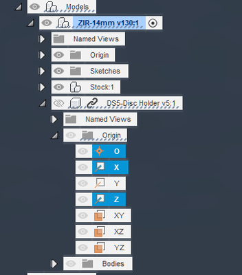

hello, I am trying to target the point, X axis and Z axis of the origin in a linked component and it is not being selected in the setup. When I do this with a non linked component, I am able to select these entities. Is there a way to select these parts in a linked component?
cam:adsk.cam.CAM = app.activeProduct
setups = cam.setups
# Create Setup Input
setupInput = setups.createInput(adsk.cam.OperationTypes.MillingOperation)
setupInput.models = machiningBodies
setupInput.fixtureEnabled = True
setupInput.fixtures = [fixtureOccurence,stockOccurence]
setupInput.stockMode = adsk.cam.SetupStockModes.SolidStock
setupInput.stockSolids = [stockBody]
# Create Setup
setup = setups.add(setupInput)
# Defin Setup Parameters
setup.parameters.itemByName('wcs_orientation_mode').expression = "'axesZX'"
setup.parameters.itemByName('wcs_orientation_axisZ').value.value = [fixtureOccurence.component.xConstructionAxis]
setup.parameters.itemByName('wcs_orientation_axisX').value.value = [fixtureOccurence.component.zConstructionAxis]
setup.parameters.itemByName('wcs_origin_mode').expression = "'point'"
setup.parameters.itemByName('wcs_origin_point').value.value = [fixtureOccurence.component.originConstructionPoint]
When I do this in a non linked component these are the results:
