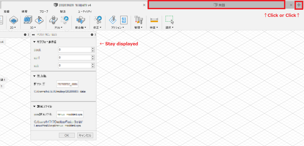

I noticed onExecute event fired when I move a project with taking out command GUI.
When I pushed the OK button, I want to run [OK] processing.
When I movied project, I want to run [cancel] processing.
However, I think that I cannot distinguish me with the argument of onExecute.
(The left image is OK pressed eventArgs, the right when moved project. I think same two)

thomasa88
What do you mean by "move project"? Can you exemplify how you do this?
Try setting cmd.isExecutedWhenPreEmpted = False
Daisuke.Inokuma1
Sorry to noisy word.
In other word, changing current project.
I tried it and solved it.
Thank you for your valuable answer!
