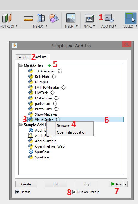

pawelzwronek
Maybe try to manually install it with this steps:
Extract somewhere attached file VisualStyles.bundle.mac.zip or VisualStyles.bundle.win.zip1.png
  1. Add-ins
  2. Add-Ins tab
  3. RMB on VisualStyles if any exists (On mac there is only on mouse button, right? Then maybe hold CMD on kayboard )
  4. Remove
  5. Green plus - add existing add-in. Choose extracted VisualStyles.py
  6. Select VisualStyles
  7. Click 'Run'
  8. Select 'Run on Startup' checkbox.
Does it worked?

JetForMe
Yes! That worked! It took a LONG time to load, locking up the UI until it figured itself out. It also asked me in the middle of that about storing preferences in the cloud (I should have answered No). but now it's all set up, I'm able to adjust which visual styles are on display, Thank you!

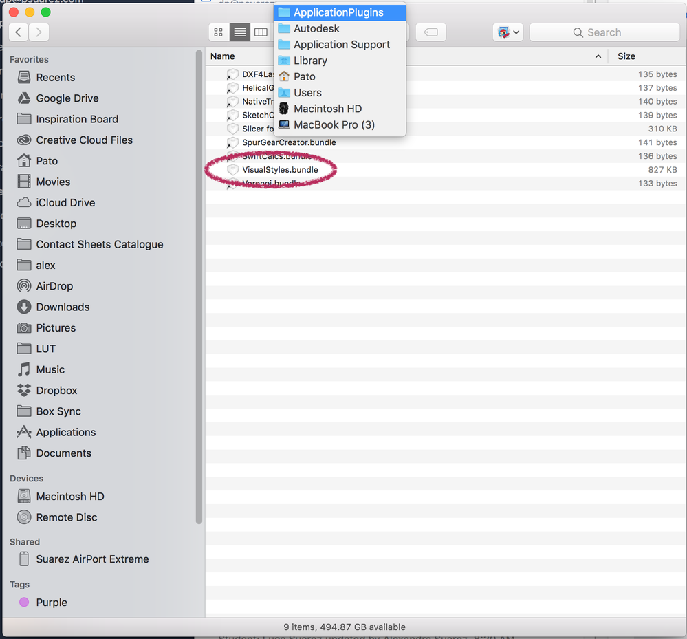

luca.giorcelli
Mac installer may not work properly, as it happened to me. But finally I've solved my problem.
Please check what you have in the library after plugin installation, this is the path: ~/Library/Application Support/Autodesk/ApplicationPlugins
If you have an alias file (icon has a small black arrow) as in the image below, then it will not work.
You need to have the actual bundle file, as in the image below.
If you have the "alias" problem, as I had, then you can solve your problem following these instructions:
  1. Unpack VisualStyles-macos.pkg, I've used unpkg 4.5 available for free here: https://www.macupdate.com/app/mac/16357/unpkg
  2. Copy VisualStyles.bundle in this directory ~/Library/Application Support/Autodesk/ApplicationPlugins
Message 56 of 100
Patofoto
Thank you Luca for all your help. I do have the actual plugin and not the alias. Don't know what is going on. Could it be a conflict with another plugin?.

luca.giorcelli
Sorry, I've no idea. I've attached my bundle (zipped). My finder sizes it 826 Kb, instead of 827 Kb sized by your finder, may be it is different. If you want you can try it.
Message 58 of 100
Patofoto
It worked!!!. Thank you Luca. Interesting finding. Wonder what is going on. Much appreciated.
