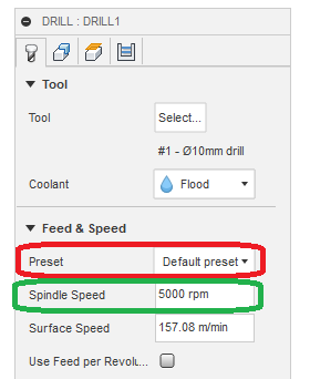

Sorry for repeating myself.
I understand the meaning of the second argument of the update method.
We create one tool and create a DRILL operation.
The settings are as follows
Next, run the script to halve the spindle speed.
The second argument is "True".
# Fusion360API Python script
import traceback
import adsk.core as core
import adsk.cam as cam
def run(context):
    ui: core.UserInterface = None
    try:
        app: core.Application = core.Application.get()
        ui = app.userInterface
        # Active Doc ToolLibrary
        activeToolLib: cam.DocumentToolLibrary = get_cam_product().documentToolLibrary
        if activeToolLib.count < 1:
            return
        # get tool
        tool: cam.Tool = activeToolLib[0]
        # get preset
        presets: cam.ToolPresets = tool.presets
        preset: cam.ToolPreset = presets.itemsByName('Default preset')[0]
        # change spindleSpeed
        prm: cam.CAMParameter = preset.parameters.itemByName('tool_spindleSpeed')
        prm.value.value /= 2
        # ToolLibrary Update
        activeToolLib.update(tool, True)
    except:
        if ui:
def get_cam_product() -> cam.CAM:
    CAMの取得
    activete_cam_env()
    return app.activeProduct
def activete_cam_env() -> None:
    CAMアクティブ
    ui: core.UserInterface = app.userInterface
    camWS: core.Workspace = ui.workspaces.itemById('CAMEnvironment')
    camWS.activate()
The result is shown here.
The spindle speed has been halved on both the operation side and the tool library side.
Restore the spindle speed and modify the script.
        # activeToolLib.update(tool, True)
        activeToolLib.update(tool, False)
Here is the result of the script execution.
The tool library has been changed as intended.
The spindle speed of the operation is not changed, but Preset is changed to "Custom".
I understood the meaning of the second argument to be whether or not it affects the cutting conditions of the already created operation.
However, it should be noted that if "False" is selected, Preset will be changed to "Custom".
