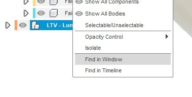

If I understand this correctly you can manipulate which portion of you design shows in the window by manipulating the Camera object. I was able to figure out how to get it to do an API "fit view" operation, which is somewhat, but not quite, what a Find In Window browser operation does.
Fit View causes the entire design (well, at least the parts of the design that are currently visible, via their Light Bulb icons) to be maximized in the window, In my case the design is taller than it is wide, so the top of the design just touches the top of the display window and the bottom of the design just touches the bottom o f the display window.
Prior to doing the Fit View my window looks like this:
AFTER the Fit View operation it looks like this:
BUT, if instead of doing the Fit View (via my C++ script) I just click on the entire project in the browser and select to Find In Window, I get this.
Which does NOT maximize the image but rather leaves some room at the top and bottom. It's kind of like the "camera" has been moved back from the object.

kandennti
Hi @RogerInHawaii .
Since I do not understand C ++, it will be explained in Python. I'm sorry.
Here is @BrianEkins  Python 'FindInWindow' sample.
https://forums.autodesk.com/t5/fusion-360-api-and-scripts/find-in-window/m-p/8614696#M7431
However, 'FindInWindow' will not be performed if the selection is canceled at the end.
Probably because commandDefinition.execute () is processed after script execution.
I experienced a similar phenomenon here.
https://forums.autodesk.com/t5/fusion-360-api-and-scripts/unexpected-behavior-with-ui-activeselectio...
Therefore, I think that it cannot be used during processing.
The Camera object has a viewExtents property, so why not increase this size?
https://help.autodesk.com/view/fusion360/ENU/?guid=GUID-1962e74e-2fc2-4821-887f-7abe2bc4c09a
After a little trial, the value was about 1.4 ~ 1.5 times that of the isFitView method.
They don't exactly match, but I don't think there is a big difference.

Here's an overview of cameras in a blog post I wrote a while ago.  It was written for Inventor but the concepts apply the same to Fusion 360 and the post just discusses the concepts.  I'm sure your problem with zooming out is because you were using an orthographic camera, which is discussed in the post.
https://modthemachine.typepad.com/my_weblog/2013/09/working-with-cameras-part-1.html
