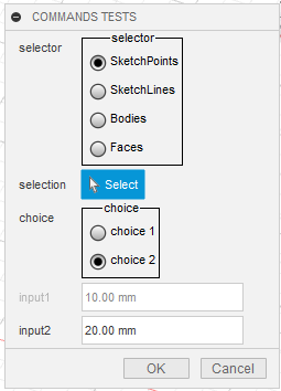

Jorge_Jaramillo
Here you have an example you can use to dynamically change the selection filter:

I hope it can help.
Regards,
Jorge Jaramillo

Hi Jorge, thank you for the code! That helps a lot. Is there also a possibility to create new input fields depending on the selection with the radiobutton or by a checkbox?
In my skript 3 splines must be selected and a plane from the origin for orientation.
Then there are two ways to choose from to produce eggshaped spans. I would like the "subchoices" only to appear by selection (check- or radiobutton):
a) equal distances (requires the fields for the distance, the checkbox if a first span should be set at 0 and the number of spans)
b) manually set distances for each span from the origin (i managed that by a textinput with csv input but actually would like to have one field and a button to create more distanceInput fields).
 best regards Jörg

Jorge_Jaramillo
I believe you can create and remove input commands dynamically (I never tried it before), but I think a good option is to create all commands from the CommandCreateHandler event, and then control with a RadioButtonCommand which of them should be enabled or disabled according with its selection, and also dynamically set their isVisible property value from the CommandInputChange event handler.
Here is an example of how to do it, with "choice" radioButton it controls input1 and input2 enabled:
COMMAND_ID = 'commandTests'

This is what you get:
You can choose either to hide or to disable the commands you don't want the user interact with.
Regards,
Jorge Jaramillo
joergDVRXK
Hi Jorge, exactly what i needed, thanks a lot.
Jörg
