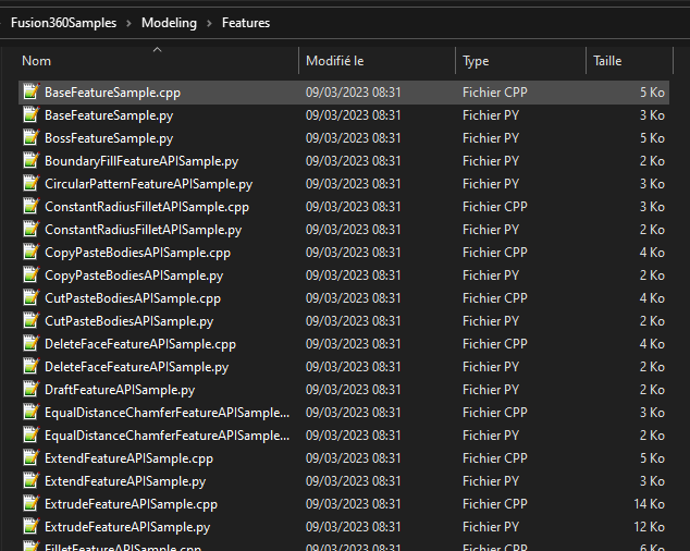

I wrote a Python script that automatically extract all the API samples from the online documentation.
I hope I can publish the zip file on a GitHub repo this weekend.
Stay tuned!

Wow, amazing @JeromeBriot, thank you so much! I'm sure many other users will be helped by your work as well 🙂 .
(Btw. for anyone else interested in offline docs, here are the api docs for download. And they can be read with Read CHM on Mac.)
