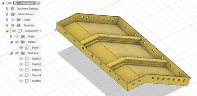

This is the final result I get:

import adsk.core, adsk.fusion, traceback, math
def run(context):
    ui = None
    try:
        ui = app.userInterface
        # doc = app.documents.add(adsk.core.DocumentTypes.FusionDesignDocumentType)
        design = adsk.fusion.Design.cast(app.activeProduct)
        # unitsMgr = design.unitsManager
        rootComp = design.rootComponent
        sketches = rootComp.sketches
        # planes = rootComp.constructionPlanes
        # features = rootComp.features
        sweeps = rootComp.features.sweepFeatures
        extrudes = rootComp.features.extrudeFeatures
        root = app.activeProduct.rootComponent
        # features = root.features
        # Create a new component for the panel.
        root_comp = design.rootComponent
        new_comp = root_comp.occurrences.addNewComponent(adsk.core.Matrix3D.create())
        panel_comp = new_comp.component
        # Create a new sketch for the panel.
        sketches = panel_comp.sketches
        xZ_plane = panel_comp.xZConstructionPlane
        panel_sketch = sketches.add(xZ_plane)
        # Define the corners of the panel profile.
        corner1 = adsk.core.Point3D.create(0,0,0)
        corner = adsk.core.Point3D.create(300,0,0)
        # Create lines connecting the corners to form the panel profile.
        lines = panel_sketch.sketchCurves.sketchLines
        line = lines.addByTwoPoints(corner1, corner)
        # Create an angled line at corner  (147.21 degrees).
        angle = math.radians(-150)
        length = -300
        end_point1 = adsk.core.Point3D.create(corner.x + length * math.cos(angle),
                                              corner.y + length * math.sin(angle),
                                              0)
        m= corner.x + length * math.cos(angle)
        s= corner.y + length * math.sin(angle)
        p= corner.x + (length+5) * math.cos(angle)
        q= corner.y + (length+5) * math.sin(angle)
        angled_line = lines.addByTwoPoints(corner, end_point1)
        # Merge the two lines
        line.endSketchPoint.merge(angled_line.startSketchPoint)
        # Get the root component of the active design.
        rootComp = app.activeProduct.rootComponent
        # Get the left plane of the root component.
        leftPlane = rootComp.xYConstructionPlane
        # Create a sketch on the left plane.
        panel_sketch = rootComp.sketches.add(leftPlane)
        panel_profile_points = [
            (0, 0, 0),
            (0, 0, 65),
            (0, -5, 65),
            (0, -5, 5),
            (0, -95, 5),
            (0, -95, 65),
            (0, -100, 65),
            (0, -100, 0)
        for i_ppp in range(len(panel_profile_points)):
                adsk.core.Point3D.create(*panel_profile_points[i_ppp]),
                adsk.core.Point3D.create(*panel_profile_points[(i_ppp + 1) % len(panel_profile_points)])
        # Now, create a profile from the closed sketch
        panel_profile = panel_sketch.profiles.item(0)
        # Create a path and let it find connected curves automatically
        path = panel_comp.features.createPath(line)
        # Create a sweep input
        sweeps = panel_comp.features.sweepFeatures
        sweepInput = sweeps.createInput(panel_profile, path, adsk.fusion.FeatureOperations.NewBodyFeatureOperation)
        sweepInput.taperAngle = adsk.core.ValueInput.createByString('0 deg')
        sweepInput.twistAngle = adsk.core.ValueInput.createByString('0deg')
        # Create the sweep.
        sweep = sweeps.add(sweepInput)
          # Create holes on the back plane of the panel.
        # Create a hole on the bottom plane of the panel.
        back_plane = panel_comp.xZConstructionPlane
        hole_sketch = panel_comp.sketches.add(back_plane)
        hole_radius = 8  # Adjust the radius as needed
        for z in range(50, 300, 50):
            # Define the center and radius of the hole.
            hole_center = adsk.core.Point3D.create(z, -40, -100)  # Adjust the position as needed
            # Create a circle for the hole.
            hole_sketch.sketchCurves.sketchCircles.addByCenterRadius(hole_center, hole_radius)
        off_set = 40
        angle_for_holes = math.radians(30)
        xo = 300 + off_set*math.sin(angle_for_holes/2)
        r = 300+ off_set*math.sin(angle_for_holes/2)
        yo = -40
        for i in range (5):
            r-=50
            hole_center = adsk.core.Point3D.create(xo + r * math.cos(angle_for_holes), (yo + r * math.sin(angle_for_holes)),-100) # Adjust the position as needed
        # Extrude the hole sketch to create the hole on the side face.
        hole_oc = adsk.core.ObjectCollection.createWithArray([prof for prof in hole_sketch.profiles])
        hole_ext_input = panel_comp.features.extrudeFeatures.createInput(hole_oc, adsk.fusion.FeatureOperations.CutFeatureOperation)
        hole_ext_input.setDistanceExtent(False, adsk.core.ValueInput.createByReal(150))  # Adjust the depth of the hole as needed
        hole_ext = panel_comp.features.extrudeFeatures.add(hole_ext_input)
        # Create a rectangle and extrude it in the LEFT plane.
        top_plane = panel_comp.xYConstructionPlane
        top_plane_sketch = panel_comp.sketches.add(top_plane)
        # Define the rectangle's corner points.
        top_plane_points = [
            (0, 0, 0),  # Adjust the position as needed
            (5, 0, 0),  # Adjust the position as needed
            (5, -100, 0),  # Adjust the position as needed
            (0, -100, 0),  # Adjust the position as needed
        rect_lines = top_plane_sketch.sketchCurves.sketchLines
        for i_point in range(len(top_plane_points)):
            rect_lines.addByTwoPoints(
                adsk.core.Point3D.create(*top_plane_points[i_point]),
                adsk.core.Point3D.create(*top_plane_points[(i_point + 1) % len(top_plane_points)])
        # Create a profile from the rectangle.
        rect_profile = top_plane_sketch.profiles.item(0)
        # Extrude the sketch to create the rectangle.
        extrudes = panel_comp.features.extrudeFeatures
        # prof = panel_sketch.profiles[0]
        rect_ext_input = extrudes.createInput(rect_profile, adsk.fusion.FeatureOperations.NewBodyFeatureOperation)
        rect_ext_input.setDistanceExtent(False, adsk.core.ValueInput.createByReal(65))  # Adjust the extrusion height as needed
        rect_ext = extrudes.add(rect_ext_input)
        side_plane = panel_comp.yZConstructionPlane
        hole_sketch = panel_comp.sketches.add(side_plane)
        for z in range(50,100,50):
            # Create a hole on the left plane of the panel.
            hole_center = adsk.core.Point3D.create(-40, -z,0)  # Adjust the position as needed
        hole_ext_input.setDistanceExtent(False, adsk.core.ValueInput.createByReal(5))  # Adjust the depth of the hole as needed
        hole_ext = extrudes.add(hole_ext_input)
        # copy, rotate and move left panel
        #  - copy the boby into the same component
        tilt_left_panel: adsk.fusion.BRepBody = rect_ext.bodies[0].copyToComponent(new_comp)
        #  - select the edge to rotate it (the longest, lowest and internal edge)
        tilt_edge = sorted(tilt_left_panel.edges,
                           key = lambda e: e.length + e.startVertex.geometry.x - e.startVertex.geometry.z,
                           reverse = True)[0]
        #  - rotate the body
        move_feature_input = panel_comp.features.moveFeatures.createInput2(adsk.core.ObjectCollection.createWithArray([tilt_left_panel]))
        move_feature_input.defineAsRotate(tilt_edge, adsk.core.ValueInput.createByReal(math.radians(180) - angle))
        panel_comp.features.moveFeatures.add(move_feature_input)
        #  - move the body at the end of the angled_line
        source_point = tilt_edge.startVertex if tilt_edge.startVertex.geometry.y == 0 else tilt_edge.endVertex
        move_feature_input.defineAsPointToPosition(
            source_point,
            adsk.core.ValueInput.createByReal(300 + length * math.cos(math.radians(-150))),
            adsk.core.ValueInput.createByReal(0),
            adsk.core.ValueInput.createByReal(-length * math.sin(math.radians(-150))),
            True
        # combine feature to group all body-parts
        panel_comb_fea = panel_comp.features.combineFeatures
        tool_bodies_oc = adsk.core.ObjectCollection.createWithArray(
            [panel_comp.bRepBodies[i] for i in range(1, panel_comp.bRepBodies.count)]
        comb_input: adsk.fusion.CombineFeatureInput = panel_comb_fea.createInput(
            panel_comp.bRepBodies[0],
            tool_bodies_oc
        comb_input.isKeepToolBodies = False
        comb_input.operation = adsk.fusion.FeatureOperations.JoinFeatureOperation
        panel_comb_fea.add(comb_input)
