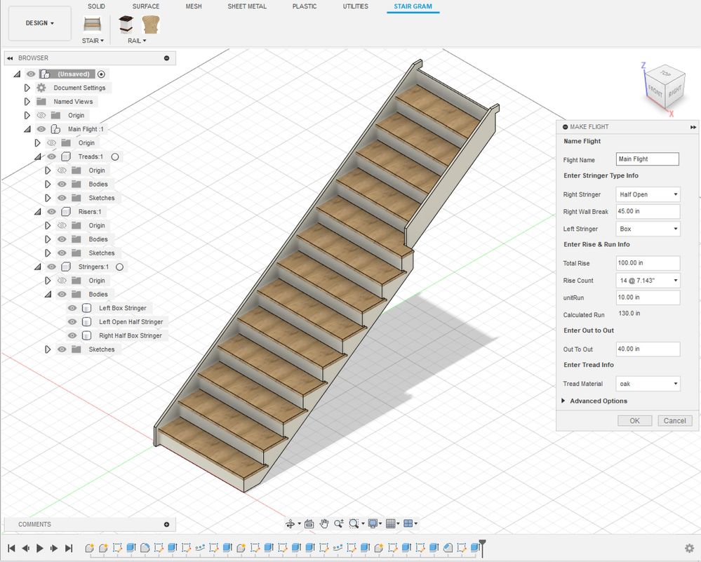

Use case: have been working on an Add-In for the past few years that takes user inputs and creates various stair flights (see accompanying picture). This has worked very well for me and has helped me save a ton of time for my business and hopefully will help me scale in the future as I can have other employees use the tool. I initially designed the whole add-in to work in a direct modeling environment, since it seemed easier to code for at the time. After testing the program extensively in the field, I realize the huge advantages of parametric modeling, and would really like to integrate it into the tool that I've created.
My Eventual goal is to group the entire make-flight operation into a singular base feature with the ability to retroactively change parameters just like you would be able to for any other tool in F360.
If I could just understand how to make a cylinder with a parameter-based radius in the API, I think I should be able to apply that concept to what I currently have.
I would greatly appreciate any help!
