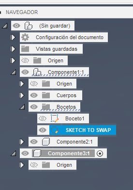

I'm looking for a method to move a sketch from one component to other one via API. The result expected is the same as if drag it manually in the user interface like this:
BEFORE:
AFTER:
Any idea about this?

Hi @en9y37 .
I could not find that function in the API.
Not in a good way, but it was possible using text commands.
The following sample creates a new occurrence, sketches and extrudes it.
Then move the sketch to the root component.

After executing the script, you can confirm that it has been moved by operating undo.
However, since the original sketch object's entityToken property, etc. cannot be obtained, there may be some problems later on.

Hi @kandennti
Thanks for your response. I've given a try and works properly. Nice work around!!!

Unfortunately, the API does not currently support the ability to move a sketch from one component to another.
