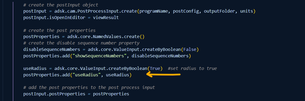

I found this very useful macro from Autodesk. This posts all toolpaths with the standard values of the properties as they are stored in the PP. Is there a way to post  by the macro so that the user customized values of the properties are used by posting ?
See macro and pic in the attached zip.

Hi @maurizio_manzi
You can add the properties you want to change in the script
for example here is the post property
called useRadius which is by default its false then if you want to set it true then in the py script you can add something like below most of the codes are already present in the script you just need to add the props you want to change
