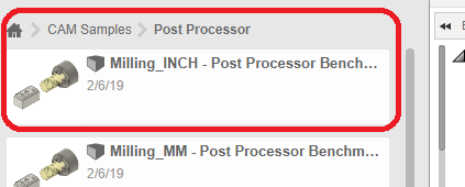

I'm testing it with the sample data here.
