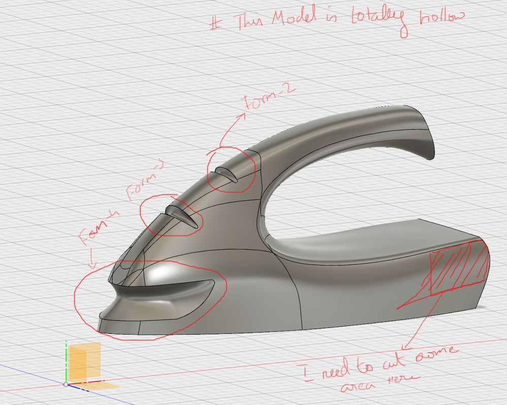

how to combine various forms into single model

It's not very clear to me what exactly do you want.
It will be appreciated if you can provide the actual model file and explain more about the detailed workflow.

zhongyang.chenK3XZJ
I cannot access to the link since it requires password.
It will be great if you can export your design as an .f3d file and attach it here.

zhongyang.chenK3XZJ
I can get the model now.
As far as I know, the existing form features cannot be combined into a single one.
But in this design, it looks there're no dependencies between the three form features.
So maybe you could just remove the 3 existing forms and then create a new form that patches the 3 areas.
In fact, I don't exactly know the reason you want to combine those forms into a single.
Perhaps you could give me more information about your intent?
