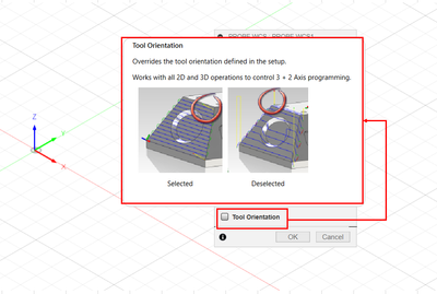

hi, everyone
I want to show a help picture when mouse on  a textbox like the picture.
eg. when mouse move on Tool Orientation, the help picture will be showed.
Thank your for your help.

Hi @ho-kou -San.
For TextBoxCommandInput, it seems that HTML formatting tags can be used in the tooltipDescription property.
https://help.autodesk.com/view/fusion360/ENU/?guid=GUID-fd65f2ef-ad50-4888-900c-3daa169133a8
I made a sample here.

The execution result is here. When the mouse cursor is hovered over TextBoxCommandInput for a certain period of time, tooltipDescription is displayed.

Succeeded to use toolClipFilename to show picture.
