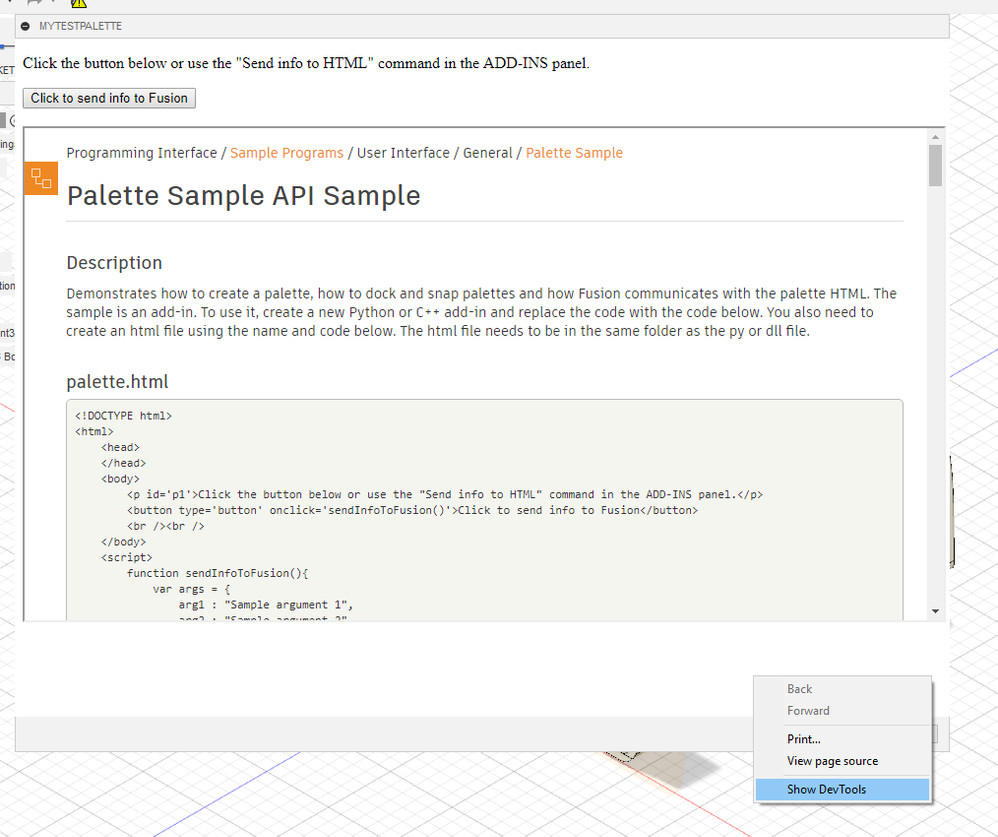

Hello everyone!
I have trying to develop Fuion360 add-in base on palette and this sample. I general my application should be able to send data from Fusion to the website, which is loaded in palette, and send data in opposite direction from website to Fuion360.
But unfortunately I have encountered an issue of determining a moment of time when pallete finished initialization.
With out it any requests from JS code to Fusion360 fails with error
adsk.fusionSendData('send', data);
Uncaught ReferenceError: adsk is not defined
    at sendInfoToFusion (palette.html:20)
I was trying to wait for ADSK object initialization by simple JS script
window.onload = function () {
		var adskWaiter = setInterval(function () {
			console.log('wait for adsk object');
			if (window.adsk) {
				clearInterval(adskWaiter);
				adsk.fusionSendData('send', '{"arg1":"Sample argument 1","arg2":"Sample argument 2"}');
		}, 500);
And some times it works, but in most cases ADSK became available only after I opened devTools
Could anyone suggest how to force adsk object initialization, and catch moment when in finished?

adsk object initialisation is done when url is loaded in palette so I think the time page is fully loaded in palette, it can be assumed adsk object is initialised. I tried the script attached with the query but did not notice any problem.

The script works on MAC version of Fusion and don't work on Windows version 😞
goyals
Well a defect is already created on our side to track it. The one possible workaround is to load the URL again in the palette which can be done using property htmlFileURL. It is like refreshing the page. I understand it might not be right thing but just give a try in case it helps. Thanks
