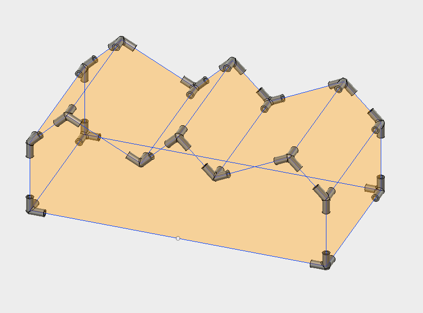

I’ve been doing some educational projects with Fusion360 and 3D Printing.
I designed some simple structures - bridges and lampshades, and modeled the connectors and then with a BEETHEFRIST 3D printer the connectors were printed, and finally the structures were assembled.
Now I intend to work with more complex and large scale structures, but it will be impossible to model each connector manually, so I came for your help.
I already started looking for Fusion360 API in order to create an algorithm to automatically generated all the connectors from the desired structure.
The dimensions to control in the connectors are: length, interior diameter and exterior diameter.
I think the steps to create the algorithm are:
1 - find sketch lines
2 - identify start and end of the lines
3 - for each start and end of lines create a “pipe”
4 - combine the “pipes”
I know that it already exists a “pipe” script in the “Scripts an Add-ons” in Fusion360 with good documentation, but I don’t have much knowledge in Python and this seems to be a really difficulty task.
Once again I really appreciate if anyone could help me with this.

I have some questions about the sketch lines that would affect my approach to the problem.
  • Are all of the lines in a single sketch?
  • Do the lines that come together at an intersection all share the same point?  That is, if you move one of the points, do all of the lines move with it?  Or are they completely individual and their start and end points just happen to be at the same location?
If the lines do share a common point then my approach would be to get all of the points and then use that connectivity information to find all of the lines that come together at that intersection and then construct the connector.  If the lines do not share a common point then I would still want to take a similar approach but I would need to do an extra step of calculating which lines connect to which corners.  I would also do the modeling in either a direct edit model or in a base feature.  In both cases no parametric data is captured and the construction will be much faster.
Brian Ekins

Hello ekinsb,
  • Are all of the lines in a single sketch? No
In this first phase I will generate the structures in Fusion, and I will design in different sketches.
Later on, the structures will be generated outside Fusion - I will use nTopology Element (a lattice topology generator) - when imported to Fusion I think the entire structure will be on a single sketch. But for now let's assume that the lines will be designed in different sketches.
  • Do the lines that come together at an intersection all share the same point? No
    • That is, if you move one of the points, do all of the lines move with it? No
    • Or are they completely individual and their start and end points just happen to be at the same location? Yes
Thanks for your help.

I was going to write up the general approach I would take but once this is an interesting problem and I couldn't help but write some code.  The coding went smoothly so I went ahead and finished it.  Here's the results of what the program below creates.  The code currently looks for all sketches in the root component that have "Connect" as part of the name.  For example I had a sketch named "Sketch 1 (Connect)" and "Sketch 2 (Connect)".  It passes this list of sketches to a function that then builds all of the connectors.  The different inputs are hard coded in the program (length, outer diameter, hole diameter, and the maximum distance two points can be away from each other to be considered the same.  And since you're 3D printing them I thought why not add fillets between the cylinders in the connector, so there's also a variable for the fillet radius.  Each connector is a separate component.
There are probably some simpler ways to approach this but this is my quick solution.  Hopefully you'll be able to figure out what I'm doing but I know some of it's not obvious and I got lazy with my commenting because I was in a hurry and just wanted to see if I could get it to work but I don't have any more time I can spend on it.

I'm having some issues with the intersections in sketches, in some intersections the connectors are not being generated.
Could you please send me your Fusion project?
Message 6 of 11
ekinsb
Attached is the Fusion file I used for testing and also the complete script.  I made a small change to it so that it reports when the fillet creation fails.
I'm wondering if you have cases where the lines don't come together (within a tolerance) at their ends.  For example if you have a line and then have another line that connects to the midpoint of that line to create a T.  Because the connection is not at the line end points it is not recognized as a connection.  If the first line is split where the other line connects, then it will work.
If that's not the issue and there's something else I can see if it's a simple issue to address or not.
Brian Ekins

I was doing simple tests, in the pictures bellow I will show what is happening and the issues that I've found.
For example, if I design a sketch with lines only in the same plane, some issues will occur during the connectors generation.
But then if I move vertically some intersection points of the same sketch, I don't find the previous issue.
Here's another issue:
Attached there are the files with Fusion projects.
Thanks.

The problem with the house model is that I was getting the points in sketch space instead of model space.  That was an easy fix.
The problem with the rectangle is what I think is an arguable bug in the API but I need to discuss it with some others before I log a bug.  The problem is that if the construction plane I'm creating a sketch is parallel to the base construction planes it creates the sketch so the normal of the sketch is the same as the base construction planes instead of the construction plane I'm creating it on.  That causes some of the extrusions to go in the wrong direction.  If you leave everything flat and rotate the sketch a fraction of a degree, then it all works because the new construction planes aren't parallel to the base construction planes.
I've added a workaround in the code to sketch if the sketch normal is in the expected direction or not and reverse the extrude direction if it's not.  The new script is attached.

Thanks for the script update, the generation of the connectors is now much faster.
As you suggest I rotated the rectangle some degrees, and it solved the problem, by doing this the fillets of the outside connectors are not generated, but for me it's ok.
I will be doing some more tests, if I detect other problems I will let you know.

Again thank you very much for all your support!
André
Message 10 of 11
ekinsb
The .manifest file just holds some other data associated with the script. It's not absolutely required for a script but is needed for an add-in.  When you create a new script using the Scripts and Add-Ins dialog it will create a new folder and create a .py and .manifest file in that folder where the folder and the files all have the same name.
Brian Ekins
Mod the Machine blog
Message 11 of 11
ekinsb
Also, the fillets probably failed because they were too big to fit in between the cylinders.  If you reduce the size of the fillet radius it should work.
Brian Ekins
