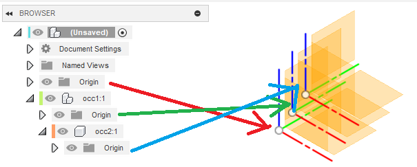

We created and tested simple data.
The "ooc1" was moved X10mmY20mmZ30mm,
ooc2" is the data with X10mmY20mmZ30mm shifted further.
The following script was created and executed
The "transform" property is obsolete, but is still available in the current version 2.0.18950.

Here is the result of the execution.
Fusion360 Ver2.0.18950
occ1.transform2 : origin(1.0, 2.0, 3.0)_vecX(1.0, 0.0, 0.0)_vecY(0.0, 1.0, 0.0)_vecZ(0.0, 0.0, 1.0)
occ1.transform : origin(1.0, 2.0, 3.0)_vecX(1.0, 0.0, 0.0)_vecY(0.0, 1.0, 0.0)_vecZ(0.0, 0.0, 1.0)
occ2.transform2 : origin(0.0, 0.0, 0.0)_vecX(1.0, 0.0, 0.0)_vecY(0.0, 1.0, 0.0)_vecZ(0.0, 0.0, 1.0)
occ2.transform : origin(1.0, 2.0, 3.0)_vecX(1.0, 0.0, 0.0)_vecY(0.0, 1.0, 0.0)_vecZ(0.0, 0.0, 1.0)
Here is the result I expected from occ2.transform2.
occ2.transform2 : origin(2.0, 4.0, 6.0)_vecX(1.0, 0.0, 0.0)_vecY(0.0, 1.0, 0.0)_vecZ(0.0, 0.0, 1.0)
It is probably broken now.

Sorry I made a mistake.
        occ1: fusion.Occurrence = root.occurrences[0]
        occ2: fusion.Occurrence = occ1.component.occurrences[0]
        occ2 = occ2.createForAssemblyContext(occ1)
The transform2 property is working correctly.
However, what you need is the transform property.
