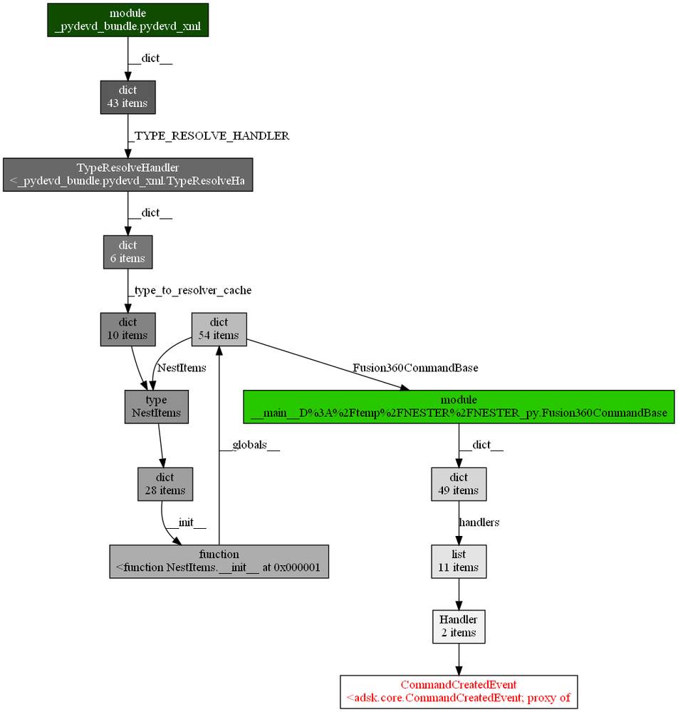

I've been experiencing issues with F360's integration with VSC ever since Spyder was replaced.  I've also been having ongoing PM conversations with @goyals for the last 9 months and I was hopeful that the new debugger release in September would have resolved the issue, but it still lingers.
The issue is that while debugging and frequently after an error is found, particularly with a hierarchy of python modules and more particularly when creating and debugging event handlers, the event handlers do not get deleted as expected when refreshing the code.  I would surmise that something is keeping a reference to handler objects, such that garbage collection doesn't see that the handlers have been released.
When this happens you get multiple calls to the same handler, and it is obvious that older versions of the handler are not removed.  If the handler code is altered (as would happen if you find a bug) it is clear that VSC still has a link to the old handler code version, and single step tracing follows the old code lines.  For example Variables you expect to have corrected values, still behave as if nothing has changed.  Attempts to actively delete or clear previous handlers fail (if reference pointers are still available).  So, in the immediate debugging command line entering
event.remove(handler) --> results in True
 no matter how many times you execute this.  If the handler was actually removed, it should result in "False" the next time this command is invoked.  This may happen to be a quirk of the VSC/F360 API interface, but it's symptomatic of the underlying issue.
Unfortunately when this this issue arises it is persistent and it's impossible to clear the old handlers, even after breaking the link to the code in VSC, stopping the process under Tools-|Add-ins|Scripts and Add-Ins and then closing down VSC.  Restarting VSC and the debugging session from fresh does not clear the issue - the only way is to shut down and restart F360.

KrisKaplan
Peter,
OK. With these steps I was able to see your double events. After some digging through the garbage collector, I am seeing that all the event handlers are being held by a dictionary, and it turned out to be the 'handlers' dictionary in the 'common' module. The problem was that 'common' was not being relatively imported by your 'utils' module. And 'utils' was imported before the relative 'common' in the NesterCommand module. This winds up leaving an absolute 'common' in sys.modules, and that is not deleted as part of the relative module cleanup when we stop the addin. Changing this to a relative import does resolve this. (I believe the reason the attemp to manually clear handlers in the stop method didn't work in this restart case because the module that 'stop' was in was using the relative imported module, but the command handlers were added to the absolute imported module.)
But there is another problem going on with this. The pydev debugger was also holding onto references to the class you had the breakpoint in. This would cause the module, and all the references it was holding (including the handlers array in 'common') when you used restart. The objgraph results of one of these event leaked references is shown below. Basically, there are references to types in a couple of caches in this pydevd_xml module. In an upcoming release, I can add clearing this cache dictionaries in pydevd as part of the 'unload addin' code. (But this wouldn't have fixed the strong references from the absolute imported common module keeping these handlers alive.)
Until this code change gets in, you can manually force detach these caches after stopping your addin with the following:
sys.modules['_pydevd_bundle.pydevd_xml'].__dict__['_TYPE_RESOLVE_HANDLER']._type_to_resolver_cache = {}
sys.modules['_pydevd_bundle.pydevd_xml'].__dict__['_TYPE_RESOLVE_HANDLER']._type_to_str_provider_cache = {}
gc.collect()
FWIW: This is a bit of a whack-a-mole issue are references. The Python debug modules, and Python in general aren't exactly designed with dynamic reload in mind. There's a lot of ways to indirectly leak references to modules that could cause things like this, so it could pay to get comfortable with the garbage collector and tools like objgraph. And keep an eye on what modules your addin adds to sys.modules when it runs (look out for absolute imports that you intended to be relative). But note that if we remove your relative imports from sys.modules on 'stop', it will not guarantee that these modules go unreferenced if there is something else keeping it referenced (in which case, you will just see your types in the garbage collector (gc.get_objects())).
Kris

pludikar
@KrisKaplan
Kris,
I'm relieved that I haven't gone totally bananas😊
Running the three code lines to clear the '_TYPE_RESOLVE_HANDLER'  dicts worked.  Thank you - I wouldn't have found that in a month of sundays, or at least not until I had dived deeply into the depths of Python/F360 internals.
 The "The problem was that 'common' was not being relatively imported by your 'utils' module" is not implicitly obvious as the import was actually relative in the code ("from .common import *") but, as I understand it, it surreptitiously became absolute because of the order in which it was called.  Am I right?
I think, in summary, it was 50/50 me causing inadvertent and very obscure coding errors and F360/Python/VSC not being totally robust against those errors.  Unfortunately, I was fully expecting to focus on debugging my code and not the underlying environment.  But... I'm really pleased that the bottom has been found (it's been a long while in the making).
I will definitely dig into gc and objgraph, but I would suggest, because F360 is highly sensitive to having relative module references, having an inbuilt tool(s) or command(s) that simply identifies/removes any absolute referenced modules would help anyone in the future who comes across this issue.  Maybe something like LINT would be useful too. Although having these __dict__s emptied on disconnect would be my equal 1st choice.
The biggest things for me was that when this happens, it doesn't become obvious immediately - no error tracebacks, just making code changes that don't actually get incorporated on debug.
IMHO The more robust and bulletproof you can make F360/API/VSC the better it will be for everyone in the future - I am happy to help break and test the environment😁
Anyway, thanks very much for your help - I look forward to seeing your code updates.

pludikar
Hi Kris,
FWIW: I now have my VSC is the faulty situation.
  • I stopped at a breakpoint at the end of onRun (after my code has been initiated)
  • imported gc and objgraph
  • did gc.collect()
  • then collected all objects into variable - objs = gc.get_objects()
  • filtered list to modules -  objs1 = [for x in gc.get_objects() if type(x) == types.ModuleType]
  • filtered obj1 to modules with 'nest' in the name - objs2 = [x for x in objs1 if 'nest' in x.__name__.lower()]
  • and just to make it easier created a similar list with names only -
    objsname = [x.__name__.split('%2F')[-1] for x in objs1 if 'nest' in x.__name__.lower()]
  • looking at this list there were several copies of NesterCommand:

  • The objgraph (2) of an early version in the list reveals:suspendedNester.png
  • The objgraph (37) of the current (last version) reveals this:activeNester.png
  • I don't know if this helps, but it appears that the early version is in a suspended frame (If I interpret that right).  It may be a VSC issue, but unfortunately you are the ones who need to get it fixed, or go to another IDE.
