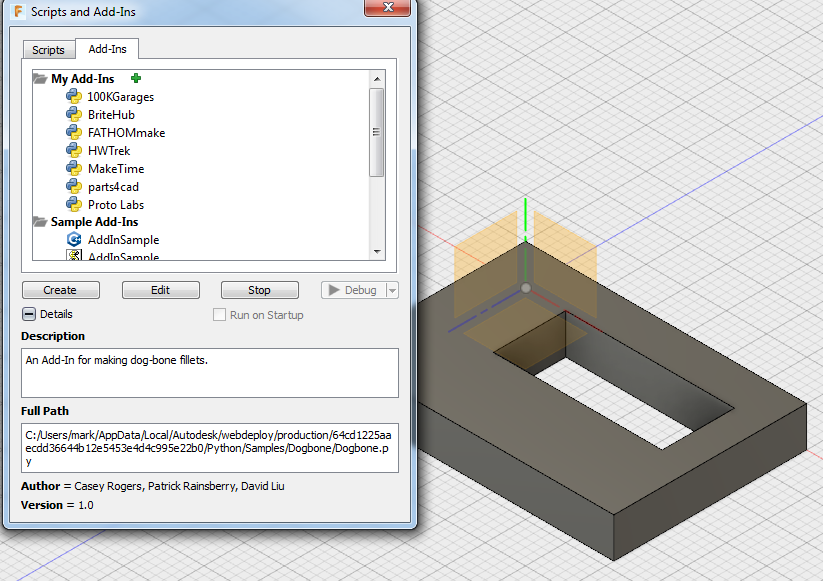

I'm trying to use the Casey Rogers Dogbone Add-in/ but I'm running into an execution error. When I select a corner in my project and click on the dogbone icon, it consistently pops up the same error message. The error is in line 140 of utils.py. Specifically it says "line 140, in notify notify_method(args). Lower in the error popup (after the listing of the stacked calls) it reads: "RuntimeError:2 : InternalValidationError : input -> evaluateString(xlVal->valueAsIString(), dTemp, bValueStrChanged).

Instructions for Windows directory are wrong, searched for the spurgear.py program to find the directory where Add-Ins exist on my system.
The error pops up when starting the add-in. Initially I was able to make it work on two edges without a pop up error but it was at 90 degree angle.

I had trouble finding the directory to put the folder in to make it show up but I noticed the + sign in the app addin so I just put the folder in my documents folder and added it from the fusion application.

I am having a problem with the dogbone addin opening the user setting window. I have put it in the below location. When I run it I get a window that says only "Hello admin" see picture below. I cannot seem to get it to launch. I do not know what I am doing wrong.
C:/Users/Lonnie/AppData/Roaming/Autodesk/ApplicationPlugins/Tapnair/Dogbone-master/Dogbone/Dogbone.py

prainsberry
Hey not sure what exactly is happening.  But try putting it here:
C:/Users/Lonnie/AppData/Roaming/Autodesk/Autodesk Fusion 360/API/AddIns/Dogbone/
Then the add-in should show up in your script/add-ins dialog automatically.

I have added your version to C:/Users/Lonnie/AppData/Roaming/Autodesk/Autodesk Fusion 360/API/AddIns/Dogbone/ , then went through the create and it does show up.
It runs, but the options screen does not show up , just this windowDogbone.JPGWhen you click on ok no other menue shows up.

When you go into the addins dialog you are basically 'turning on' the addin.  THen it puts a command in your "Create" menu.  So you can use the dogbone feature from there.
Is that maybe the issue?

The Dogbone Addin issue is resolved. Instead of adding the program via the
"create" button, I added via a green plus sign.
Second, I was not aware the feature would show up under "Create Dropdown"
This is a great addin and I am happy that it is working.
