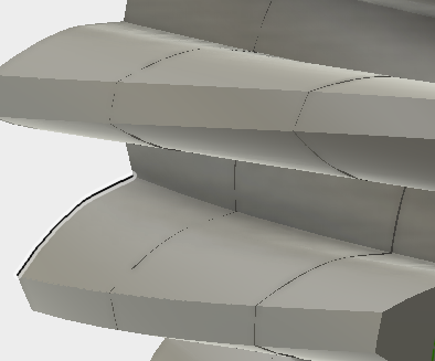

I see a double helical gear - is that what you are trying to do with your addin? If so be aware of my helical gear generator and I'll share that I'm nearing delivering version 2.0 which will add a lot of features (including directly creating double helix gears).
Message 12 of 19
Yeah, I am aware of that one. I wrote this a long time ago (about the same time as you released your first version) but never published it because you got there first. 🙂
Now I tried my Addin again and it seemed to have some broken bits with the updates so I decided to fix these. But I was thinking I may share it(if fusion shop will take it) since it did have some functionality the Helical Gear Generator didn't seem to have, like the herringbone gears, choosing between simulating(undercut compensation and profile shift) and calculating the tooth profile, diametral pitch and circular pitch instead of module, different types of profiles for the inner hole and so on.
Mine seems a bit slower though because it generates the whole profile in the sketch instead of multiplying 3D shapes. I also wrote a (hopefully proper)bevel gear generator around the same time that approximates the tooth shape, maybe I should fix that too.
Message 13 of 19
And/or maybe we should work together 😛 mines written in python - I would really appreciate having a second brain on this stuff. I would be happy to share my Alpha code with you (no obligation), it's quite rough at the moment (the code that is... and the preview experience), and I have a lot of work to do on improving performance, but it is otherwise fully functional.
The code under the hood in my v2.0 can also compute shifted profiles but as profile shifting only makes sense when you are dealing with 2 gears I'm not planning to expose that ability (yet). In addition to what I show below the code is also capable of making some crazy things and it can sensibly generate involute profiles up to 89 deg pressure angles (which are totally useless as gears obviously)
I've also written the code to generate proper spherical involutes for bevel gears but I haven't taken it to fully generating a gear - largely because along the way I learned that without crowing bevel gears (esp. 3D printed ones) are not likely to operate smoothly and that just seems like a real pain to make happen in the fusion API.
Internal double helical gear with capping and point reliefInternal double helical gear with capping and point relief

Try using the new twist sweep instead of the guide rail sweep, it's a lot more accurate and a lot faster
Here's my "twist calculator"
class TwistCalculator(object):
  def __init__(self, helix_angle, pitch_radius):
    self._c = math.tan(math.pi/2 - abs(helix_angle)) * pitch_radius if helix_angle != 0 else None
    if helix_angle < 0:
      self._c *= -1
  def reverse(self):
    self._c *= -1
  def twist_over_displacement(self, displacement):
    return displacement / self._c if self._c else 0
And then doing the sweep looks something like this
sweeps = self._component.features.sweepFeatures
si = sweeps.createInput(profile, self._path, adsk.fusion.FeatureOperations.NewBodyFeatureOperation)
si.twistAngle = adsk.core.ValueInput.createByReal(self._twist_calculator.twist_over_displacement(self._length))
sweep = sweeps.add(si)
Bevel Gears...
I'll have to look into tredgold approximation - I'm strait up computing the involute on a spherical surface. Then it's trivial to project (actually ray-cast from origin) that involute onto a plane so fusion has a profile to work with. I used this source for the spherical involute math if you're curios http://thermalprocessing.com/media/2017/201703/0317-Forging.pdf I really hate "math papers" - i swear they say stuff in ways intended to make understanding hard. It's not actually that complicated of a problem to calculate a spherical involute but everything I found on the subject sure made it hard to understand!
