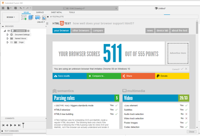

Hello
With the latest Fusion 360 our palettes collapsed, because css -rid (display:grid) is not supported in new web browser palettes. We hope that it is just a temporary flaw.
Btw: what engine Fusion 360 is using to render the html in palettes?

To check Fusion palette engine you can easily navigate your custom palette to the online checkers like
'http://www.browser-info.net' 'https://html5test.com/' 'https://ruanyf.github.io/es-checker/'
here are results of my test on Windows version of Fusion 360
Please pay attention that for MAC environment the results will be different.

Hello akonovalenko
Fusion 360 api used chrome to render the palettes, but soon it will not be supported. I suppose you were not using the new web browser. Take a look at the palettes()->add() function declaration:

I got same results as yours at browser-info.net when useNewWebBrowser == false, but the browser is not identified when useNewWebBrowser == true

We are using QtWebBrowser as new web browser for palette. Previously we were using Chromium on Windows and Mac OSX WebKit on Mac. Let us know If you notice any issue while using new browser. Thanks.
