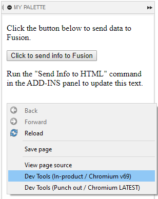

@saketsatta, @goyals, the DevTools entry is missing when right-click on a palette if useNewWebBrowser is set to True (Windows 10, Chrome 90.0.4430.72):

JeromeBriot
Thank you @saketsatta
To make it work:
1) Execute the command below in the text commands window: DevOptions.WebDeveloperExtras /on (be sure to select Txt on the right side of the window)
2) Right-click on the palette and choose "Dev Tools (In-product / Chromium v69)"
3) Click on the HTML file related to the palette in the inspectable pages list.
Devtools is now available
