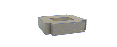

I've reported mirror related bugs before - latest one here, which has been accepted as a bug.  However, I've found yet another inconsistency, this time in the relationship between co-edges and the underlying edges in bodies that have been created via mirroring.
The script below is meant to identify any inside corner, and will create an illustrative sketch lines where the inside corners are.  The original body works as expected, the mirrored body does not.

This shows the result of the script on an original body - note the the vector representations at the corner are correct.original body with vectorsoriginal body with vectors
This is the same view of the original body, with just the sketch activeraw vectors on original bodyraw vectors on original body
This is the view of the same body, but after mirroring - note that the vectors are not only in the wrong place, but are not associated with the inside corner.  This is indicative of the underlying edge not being consistent with
coEdge.isOpposedToEdge - either the loop direction is not consistent or the co-edge and edge relationship is wrong.
mirrored body and vectormirrored body and vector
This illustrates the error.
raw vector on mirrored bodyraw vector on mirrored body
It is clear, from all the issues I've had that mirroring is significantly flawed.
I can create a screencast, if absolutely necessary, but I'm hoping this is obvious and easy to reproduce

Hi @MichaelT_123 ,
Thanks for the thought - I tried comparing the start and end parameters of the coEdges with the underlying edges - and... they are consistent with each other.  I'm pretty sure it is just further evidence that the process to create mirrored bodies, and components, is flawed ( That's nice way of saying F***** Up).
I've been struggling since before summer of last year to get AD to recognise that there's a significant flaw in their mirrored bodies and components, and hopefully the message has now got through.  I would classify this as a cat 4 or maybe a cat 5 bug ( as in the hurricane categories) - it's not totally devastating, but it causes quite a bit of damage.  If this is inherent in the model structure itself (which I would suggest it is), then it could affect millions of users' existing models, and, I suspect, a cause of existing F360 instability.
I added the following after line 42 ( in coEdge for loop)
                coEndPoints = coEdge.evaluator.getEndPoints()
                (returnValue, coEdgeParameters) = coEdge.evaluator.getParametersAtPoints(coEndPoints[1:])
                (returnValue, edgeParameters) = coEdge.edge.evaluator.getParametersAtPoints(points[1:])
                print('coEdge parameters = {}; edge Parameters = {}'.format(coEdgeParameters, edgeParameters))
This is the result:  You'll notice the start and end parameters are not only, more or less, identical but appear in the same order - the parameters between mirrored body coEdges and edges are just flipped around and negated.  If I'm understanding this correctly, the numbers suggest the coEdges and edges are aligned but, edge vectors are definitely incorrect.  This is consistent with my earlier results.
