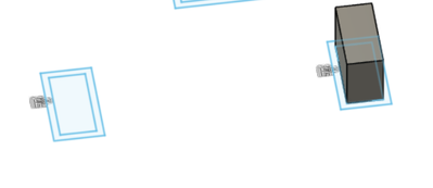

Ran into a strange issue. Using a modified version of ModTheMachine's Bounding Box Code, I found that it worked perfectly for BRepBodies. However, when I run my code on a MeshBody, it does not track the body if the body as been moved or rotated.
Some screenshots:
expected result when code is run:
expected result when code is re-run after box has been moved
expected result when code is re-run after box is rotated
However, when applied to a mesh, I get these results.
Prior to translation:
after translation:
While collecting these screenshots, I also discovered that the movement of the MeshBody cannot be undone via the timeline. How should I address this, to make the MeshBody outcome work the same way as the BRepBody? Thanks for the help in advance!
