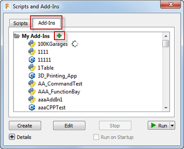

I just walked through this with somebody else on Mac that was having a similar problem. It turned out the problem is that he was using the green "+" on the Scripts tab rather than the Add-Ins tab.  I didn't think it would matter, and it really shouldn't but apparently it currently does. Can you see if you're using the Add-Ins tab, as shown below?

I tried this again, selecting Add-ins first.  Same result -- nothing.  Is your reference using OS 10.12.3 ?

I just downloaded Version 2.0.2826 directly from Autodesk and the software now works as expected -- Script and Add-in files are available from any folder location.

Sorry for the trouble. It was a bug in Fusion apple store version. I logged it as UP-33652 in our internal bug system.
