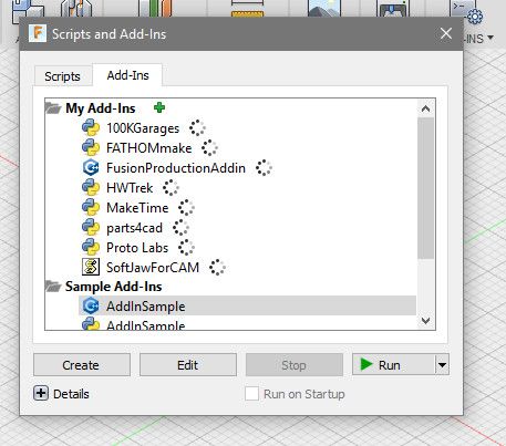

 I never noticed the others, but I tried to install the soft jaw addin, it is listed with what looks like a wait icon, needless to say, none of the addins work, any suggestions? I can stop and start them, get a message that things were added to the menu and was successful, but it does not appear on the menu it should.

For me the ParameterIO addin doent work!!!! Whats the meaning of the circular dots next to the name of addin?

The icon is meant to show that the particular add-in is currently running. User can stop any particular add-in from Script dialog by clicking on 'Stop' button. Add-in documentation should help to find out how to use that particular add-in. Hope it helps.

i am facing the same problem. when i click run the running icon appears but nothing happens.

Most add-ins add a button somewhere in the menu.
We do not know which add-ins you are using, but each add-in probably has a description that tells you where the button will be added.
