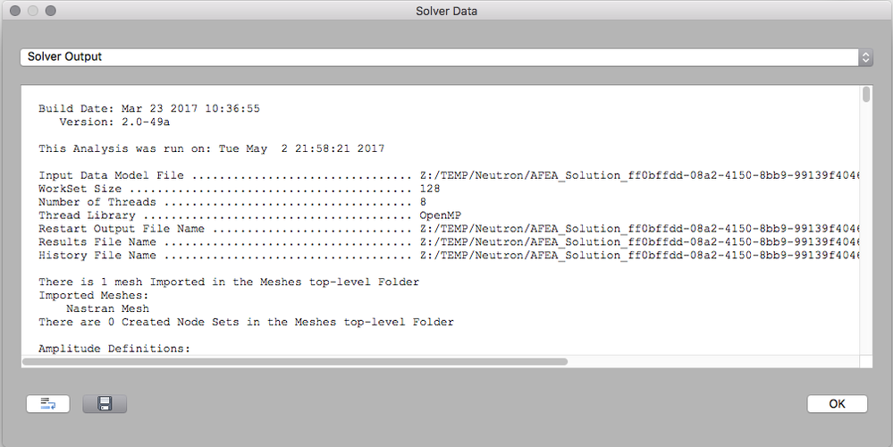

If you look at the Solver Data
... and the Solver Output
You can see the External Work and what the value is at the time that the solver outputs to the results.

In this case, there should be a conservation of energy for each step.
Total Energy = Kinetic Energy + Internal Energy + Viscous Energy - External Work
If you keep the value of Kinetic Energy very low (meaning there's not a lot of inertial forces), the solution will be quasi-static (I don't think I did a great job of this in the above example).
I don't believe there is a way to get the Reaction Force of a constraint at each time step at this time. I will have to ask around and circle back.
However, you may be able to use the External Work value above to understand the forces acting on your bottle.
I hope this helps.
