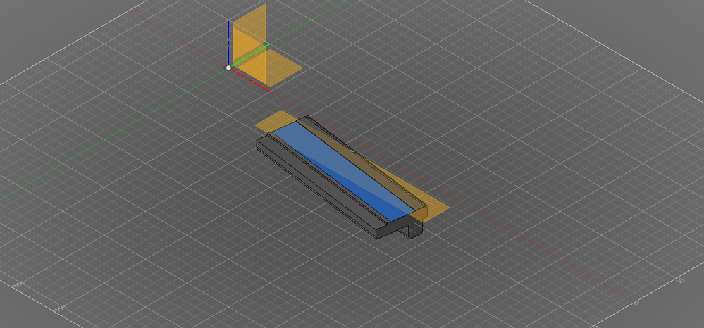

I can not define a working plane parallel to XY twisted around the Z axis.
All tests lead to a plane that is completely parallel to XY, that is, the X and Y axes of the working plane are parallel to the X and Y axes and not twisted by a proper angle.

I define the BLUE construction plane and the F360 displays YELLOW. Each way of defining this plane leads to the same wrong end result.
I need to make some hols on BLUE surface.
I think that this stupid  error in F360 is easy to repair in program
thank you anonymous programmer for a silent fix, now everything works fine
all is OK
