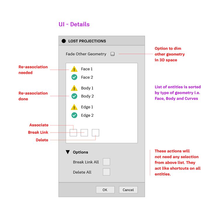

Hello Fusion Sketchers,
We know that at times, it can be pretty daunting to find and repair yellow sketch geometry, which has turned yellow due to lost references. Sometimes you have to spend time to search missing projections or just start over again to solve the nagging yellow sketch related issues.
We have listened to your feedback and are working on a brand-new way to quickly find and fix yellow sketch geometry.
Please have a look at the UI mock-up we are working on to cater these issues.
You will be able to access this Lost Projections UI, either by right clicking on a yellow geometry in a viewport or right clicking on a sketch icon which has turned yellow in your timeline.
Here is a quick example of a typical workflow –
Step 1 – Access Show Lost Projections from right clicking on yellow sketch from timeline
Step 2 – UI with lost projections is shown. Click on any entity from the UI, which gets selected in the 3D workspace with lost projection highlighted.
Step 3 – Now click on any valid geometry in 3D workspace to reassociate with already selected entity from the UI.
Step 4 – Reassociation successfully done. Icon next to the lost projected entity in the UI, turns green indicating successful reassociation. Done !
Feedback Requested
Now that you have seen what we have in mind to solve this problem, we’d love to ask a few questions:
  1. Once you have either Re-linked, Broken-link or Deleted an item in the table, would you expect that item to stay in the table with a new icon, or would you prefer for it to disappear from the table completely so that the table is empty when you’re done?
  2. Do you have any models with yellow sketch geometry in them that you wouldn’t mind sending to the team for testing?
  3. Is there anything in particular about the workflow you think could be streamlined?
As always, we’d love to hear any suggestions or thoughts on what we shared above!

maker9876
Looks pretty amazing. Well done!
1) see no harm in removing items from the list once they've been dealt with. However would have to see what happens when you click on 3d body by mistake - perhaps it would be confusing if it immediately disappeared from the list? Blink and you might not realise you'd clicked on anything at all (if the list was long).
- Wondering if the workflow properly distinguishes between when an entire body was clicked on (to establish the original projection) and when select segments of a sketch were clicked on?
- See the "delete all" option but not clear how single lines can be deleted... presumably by selecting and hitting the delete key?

Hey guys - thanks for the quick feedback. Here's our thoughts on the questions you've raised thus far:
To answer the three comments underlined above:
  • If a user ever accidentally re-linked to something they didn't mean to, the Undo tool would still be available to them whether we keep the items in the UI or not
  • Yes, each row in the table will be titled based on how the projection was initially created. If it was a body projection, then you will only be able to Re-link it to another body projection, and the same goes for individual edges.
  • Single rows in the table will be deleted by highlighting the desired row hitting the Delete button in the UI

HughesTooling
Is Undo going to close the dialog like undo does at the moment while projecting? The way project works at the moment is a bit frustrating and wastes time, seem to remember @jeff_strater had a thread asking about improvements to the project workflow. Would be nice to have access to undo without closing the Lost Projection dialog or leave all fixed items in the dialog and allow changing the selection.
Unfortunately Fusion suffers from undo canceling commands in quite a few places so instead of one click and carry on it's 3 clicks, one cancels the command, one undoes then restart the command.Smiley Frustrated

anandjoshi
@HughesTooling Undo will revert to last state without closing the dialog.
Cancel will revert all actions taken in the active command without closing the dialog.
