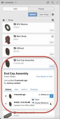

I generated an ECO, modified my design files, and pushed the ECO through the approval workflow only to see that the pre-production revision is pointing back to a revision in July instead of my last save from today. I feel like I'm missing an important step but I generated a release before without any issues. The process was create the ECO, begin modifying the files, and then close off the workflow. See the attached part history for more context.

Hi Chris, in order to update the item to the newer Fusion 360 design edits, create a Milestone of the design at the version you'd like to include in the change order.
Hope this helps!
