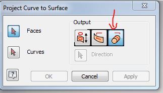

Inventor has a command called 'Ruled Surface' - is this what you mean?
http://help.autodesk.com/view/INVNTOR/2018/ENU/?guid=GUID-5A8568DF-5BDA-47B9-97FC-2722B8A78A89
PinRudolf
Hi Paul,
Thanks for asking!
Yes, that looks much like the effect i'm hoping for! Specifically creating a "ruled surface normal to the selected edge". The edge should have been created with an option similar to Inventor's Project to Surface with the option Wrap to Surface. (See link) I would like both functions to work in the model environment.
PinRudolf
Fundamentally, this is a request for the function Emboss as used by Inventor. (Other CAD software, like SolidWorks, has similar functionality)
