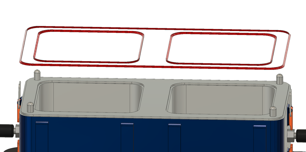

A Create Tool for Welding Joints would be kind of interesting to have but I forgot to mention how I create welds.
This is the model section that will have a weld implemented and considered into the modeling design stage. It is a section of an invention for cooking with wood/charcoal/gas and it is portable due to it being built in sections.
In this case I am designing the model to compensate for a weld. The Blue main rectangular body that has two large square holes in it is made of 1/8  inch or 0.125 inch sheet metal. However I did not use the sheet metal modeling environment. Instead I sketched out profiles that I could extrude vertically. This image shows the layers of 1/8 sheet steel.
As you can see there is no gap for the weld to fill in the joints of the metal. This is where the 2 in 1 process comes in that cuts the metal to the intended design size and creates a weld bead at the same time.
Since the metal is 1/8 inch thick I create a construction plane on the top flush surface and move it down also 1/8 of an inch so that when I make it perform a 'split body' action on certain sections of the model it creates a weld bead that is perfectly square. This image shows the construction plane in place ready to split 3 sections or bodies (the exterior rectangular 1/8th inch panel and the two internal 1/8th inch channels.
I made the 3 sections orange to show which ones are being split by the construction plane. Seen here.
Now I've performed the 'Split Body' action and re-colored the sections back to their original color but I left the results of the split orange so you can easily see how the weld bead is created while at the same time the exact and required size of the sheet metal sections is attained at the same time. This is achieved by planning ahead in the design phase and purposely extending the distance of a object extrusion or creation by a measurement that matches that of the required weld size.
In other words, you have to make the design as if it is already welded and then afterwards cut out the weld to end up with the proper dimensions for the material that would get cut to size, according to the 2D Drawings and welded together in the construction stage or manufacturing stage of the project.

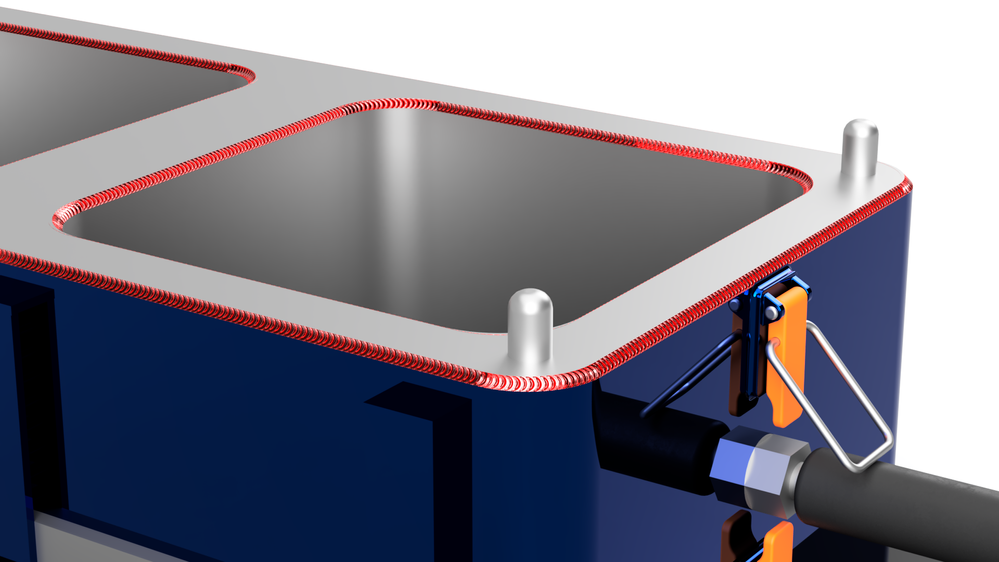

Then, although this is practically good enough I like to sometimes take it a step further and create a more realistic weld for reasons having to do with rendering and designing of the model characteristics. I chamfer or fillet the edge of the weld bead that is not in contact with the welded material. This means 3 edges contact the material and 1 edge does not. That is the edge I select to chamfer or fillet.
Then here the edges have been chamfered at 0.124 inches. Yet I went further to give the weld beads a relief pattern appearence (a realistic customized weld bead texture) and then gave it a shiny red appearance to see more easily.
Then that's it. You can then change the new 'bodies' that are the weld beads to a new component and that way they can be easily excluded when creating 2D Design Drawings which serve the purpose of blue prints in the construction stage of the design project. Here this image shows the two components separated and you can see how the 1/8th inch sheet metal sections are cut to the correct size for prepping for welding.

Finally, you end up with images like these when you perform renderings (this are quick renderings and were not drafted for best results).
