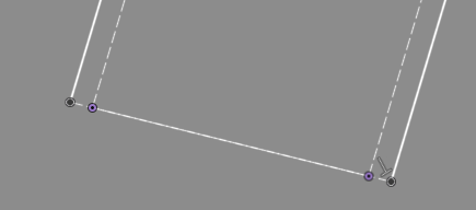

rbackman07
One use case is trying to close off a profile can be really hard to find the holes. if there are two construction lines overlapping it looks like a solid line, see below.
