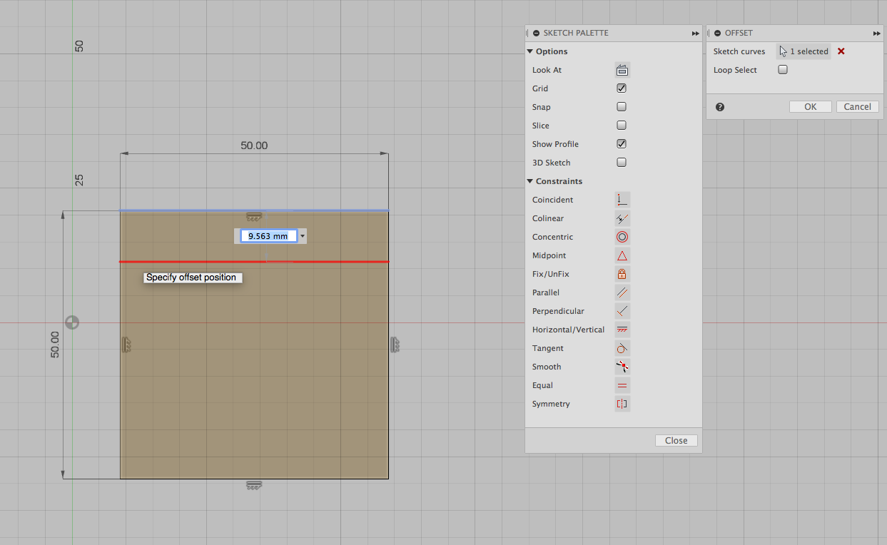

Currently, offset works like this:

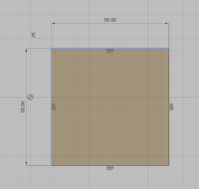

If I want to offset the selected 2 lines for example, I can't because....
this is what Fusion will do instead, and noticed that there's an option called sketch curves: 1 selected but you can't select more then 1 line.
This is how the offset of 2 lines should look like
