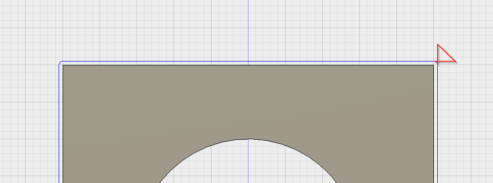

I use it with a DIY 3 axis cnc table that works both as router and as a plasma table. Designed using Fusion
When I used Fusion for plasma cutting I have a problem with cutting sharp angles. The issue is that the plasma jet (and I assume water jet) has a lag of about 15 degrees. so when you take a sharp 90 degree turn it take a while for the jet to catch up. This leads to a under cut, negative rake. So when viewed side on the cut is not 90 degree to the Z plane but at an angle of about 75 degrees
The solution appears to be instead of going round the corner you over shoot, then come back at 45 degrees and then start the next edge. See the red line in the image below.
By overshooting the corner and then have a new lead in allows the jet time to catch up
The corners look sharp when looking at the Z plane. But when looking at the X or Y plane a distinct angle is visible

We can do this in 2D Contour.
So I would expect this one is "Easy" to implement for the guys.
I've seen the request before so it's something other people want as well.
(Example of 2D Contour with roll around corners off, and set to Sharp with loop)
For some reason the guys made this not work with in control compensation. They probably had their reasons for this.

The updated Waterjet Strategies are based on the 2D contour toolpath.  So, as @Laurens-3DTechDraw suggests, this should be an easy add.  I am pinging the dev team to confirm.
Stand-by.
al.whatmough
Status changed to: オートデスク審査落選
Godo news, the team has agreed to add this.
