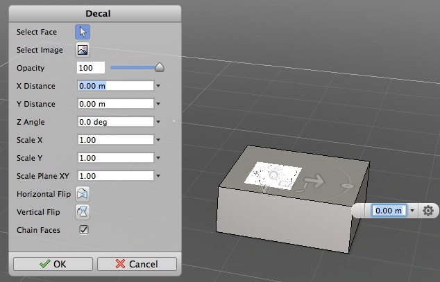

Image > Decal
Pretty okay.
Image > Attached Canvas
Now, what exactly is the difference between 'Decal' and 'Attached Canvas'?
If I got it right, I can apply both on flat surfaces, but I can only apply 'Decal' on bent surfaces s.a. a sphere. I cannot apply either on a T-Spline body.
This is not enough reason for feature separation. They are the same, splatting an image onto something.
Please correct me if I'm wrong.
