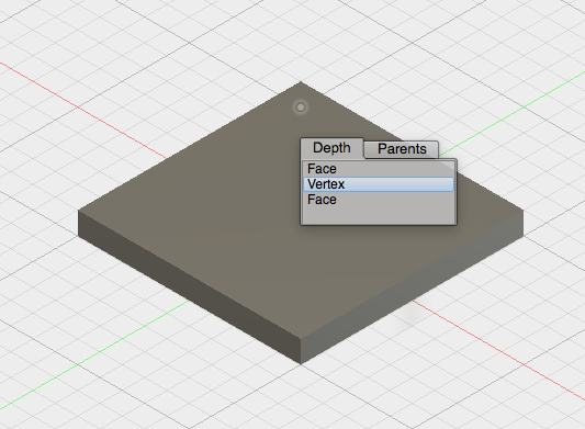

actually when you press and hold the lmb you will see a list menu

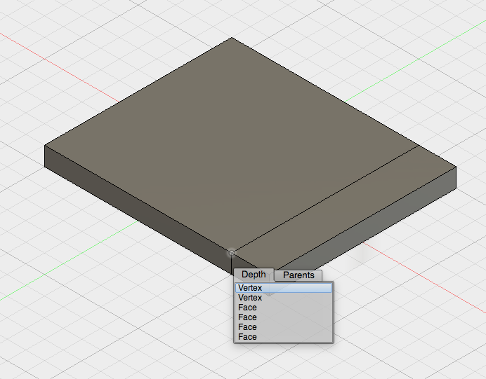

but it is not ideal as it does not highlight what vertex from what object you can select like here

Holding down the mouse button will bring up the pick list.
