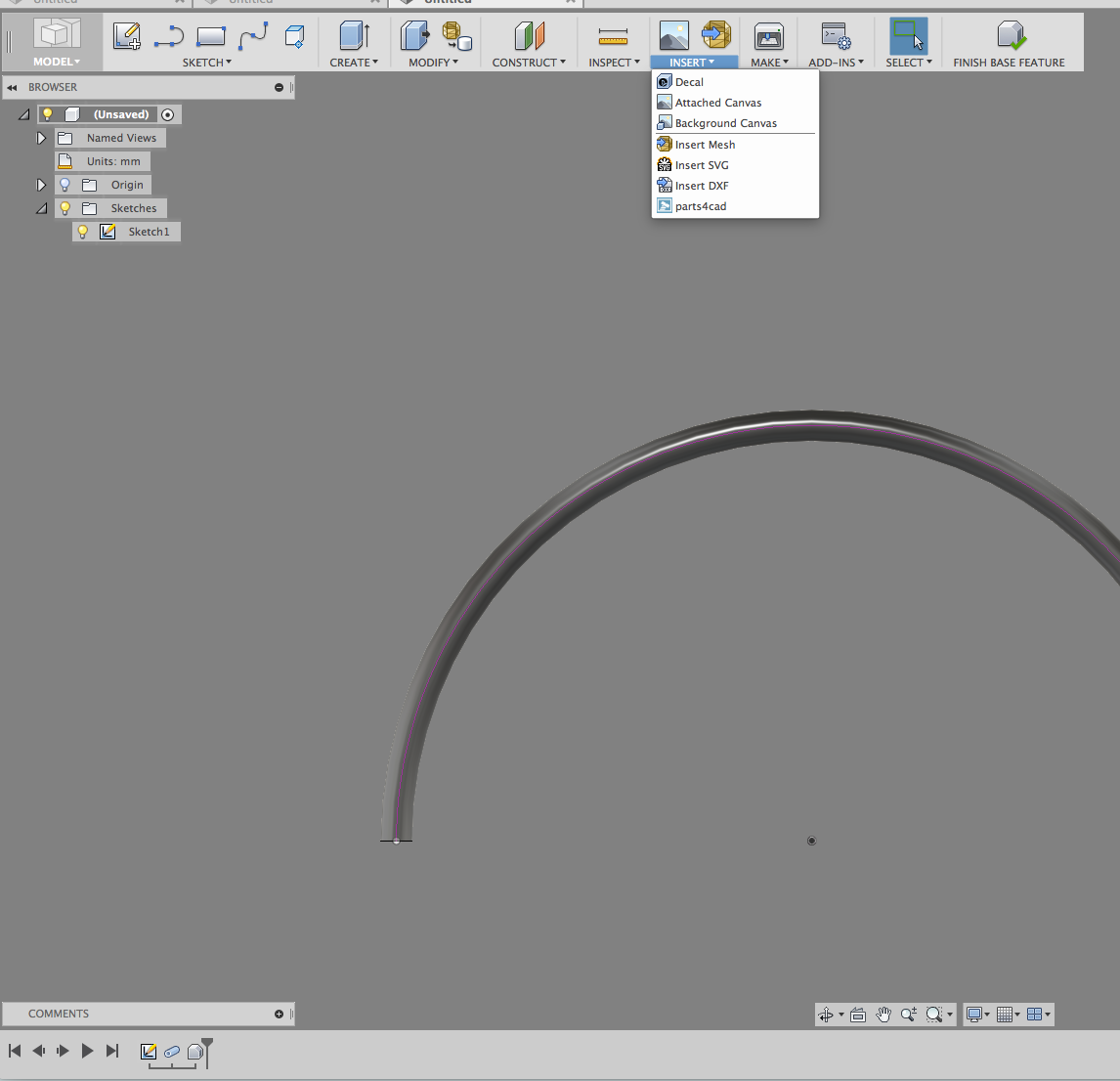

please allow professional users to import and place CAD data like STEP etc inside a base feature via the insert menu
and not the dashboard.
We have now new design from file - great!
Being able to insert CAD data right into a Fusion design is still more than needed for a fluid and fast workflow
and not having to deal with upload and process time before a designer can continue.
Screen Shot 2016-08-06 at 5.57.50 PM.pngScreen Shot 2016-08-06 at 6.00.48 PM.png

If you look in the scripts supplied with Fusion there's a script open from web.
If you look in the script's folder there's a html file, if you copy that file somewhere you can call from Chrome it gives you the option to open or insert files from your hard drive or direct from a web url without downloading first. I'd attach the html file but for some reason attachments are not allowed on the ideastation.
Here's a screengrab from chrome of the html page. I tested and you can insert into a base feature or just insert.

Wow what a nice find! This works. So fact is with this HTML working there is no technical reason why this is not already build into Fusion!
